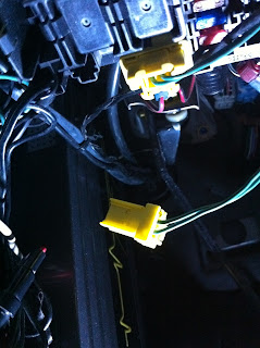

hola,
no he contestado antes pq me fuí de vacaciones jeje...
Al final lo he conseguido... Explicaré lo que hice lo mejor posible pq yo creo que fué cuestión de suerte..
Primeramente quité el fusible (el de la foto que hay más arriba) , durante unos 5 minutos.
Luego seguí los pasos de las instrucciones que he puesto en el primer post, pero sin esperar 4 segundos como dicen, lo hice un poco más rapido , entre 2 y 3 segundos.
Copio y pego las instrucciones en las que me he basado:
Friday, August 12, 2011
Honda Airbag light SRS light reset!!! Honda s2000 Acura RSX most Civics and Accords
Honda and Acura cars are known to have problems with the SRS lights, well basically all Honda/Acura because the system sometimes "hiccups" and causing codes to trip the SRS light.
DISCLAIMER: Please do this at your own risk, i am not responsible for any damages that you may cause by doing this SRS DIY reset. If you do not trust yourself, please take the car to Acura Dealership and have them reset it for you, Warranty will normally cover for reset at FREE of charge. Try this DIY at your own risk.
Note: If your airbag deployed or seats has been removed or anything that may have triggered the SRS, this DIY will not work for you. All you will get is two flashes or more and the light will remain on.
If there is NOTHING WRONG with your srs / airbag system this will work for you.. i.e. turning the key on while your seats are out of the car, turning the key on while the steering wheels is out of the car etc...
1. connect clip to yellow clip, turn key to position II
2. wait for the light to go off and remove the paper clip/wire.
3. As soon as the light turns back on, quickly connect the circuit again.
4. The light should turn back off. Remove the paperclip/wire again.
5. The light will wait a second or two
6. 2 quick flashes and SRS light turns off completely.
6-A. two quick flashes and the light remains, you may be too slow or you have a short in your SRS somewhere.
7. turn off ignition and put back the clip.
8. wait 10 sec. then start the car. srs light should go out after 6 sec.
Un Saludo
Editado por DeFiNiTiVo, 29 agosto 2012 - 21:46:48.

La idea es puentear con un clip uno de los conectores que hay junto a la caja de fusibles debajo del volante (el de las fotos) de una manera en concreto.
1. Desenchufar el conector amarillo y ponerle el clip para hacer el puente, poner la llave del contacto a la posición 2.
2. Esperar a que la luz de srs se apague y quitar el clip
3. TAn pronto como vuelva a encenderse la luz , rapidamente volver a poner el clip.
4. La luz se volverá a apagar.Vuelve a quitar el clip.
5. La luz esparara 1 segundo o 2.
6. 2 flashes rapidos y la luz volverá a apagarse completamente.
7. quita el contacto (de la llave) y enchufa el conector amarillo.
8. Espera 10 segundos , luego arranca el coche , la luz del srs deberia quitarse a los 6 segundos.
Un Saludo

Hola,
el conector del srs es el de color amarillo, no hay q volver a ponerlo en su sitio hasta el paso 7. todo lo demás es con el clip, y no da calambre no...
