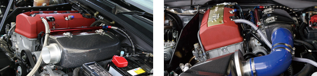

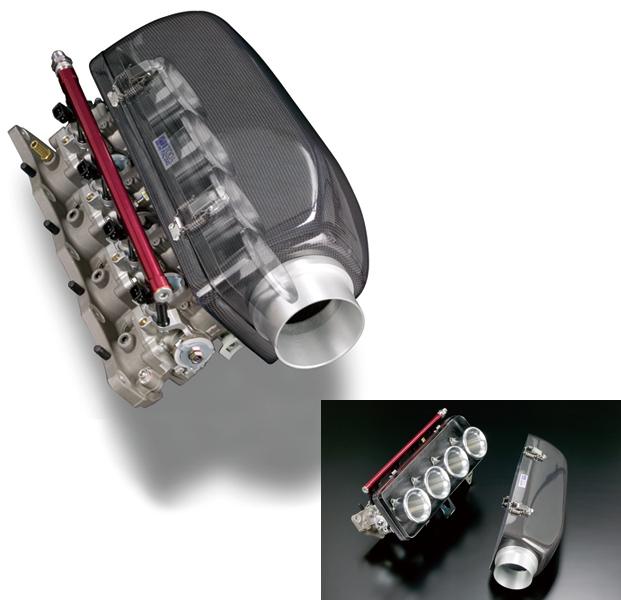

Voy poniendo algúnas que tengo por aquí...
TODA Sports Injection KIT Throttle valve size: Ø50mm
33mm ¥280,000
63mm ¥280,000
88mm ¥280,000
Inlet outer diameter 90mm. Dry Carbon made.
(Weight: 805g
90mm ¥120,000
High Power Surge Tank Inlet outer diameter 90mm. Inner diameter tapers down from 85mm to 80mm.
90mm ¥85,000
http://www.toda-raci...p/index-en.html
