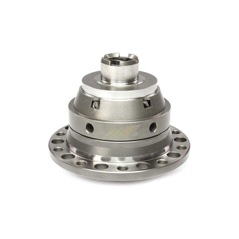

El aftermarket de Quaife (QDF14U - Honda S2000 Quaife ATB Helical LSD differential) tampoco aclara mucho:
https://shop.quaife....sd-differential
Quaife ATB Helical LSD differential for the Honda S2000. A direct replacement for the standard open differential, the Quaife ATB Helical LSD differential transforms your car’s performance. Unlike a conventional plate-style limited slip differential, the Quaife ATB Helical LSD differential relies on gears rather than clutch plates for its operation. That means it is much smoother in operation. The Quaife ATB Helical LSD differential never locks harshly with a set pre-load of wheel slip across the driven axle, like a conventional LSD. Rather, the Quaife ATB differential automatically biases the torque away from the spinning wheel across the axle, to a constantly varying degree, and never locks. The Quaife ATB Helical LSD differential has many benefits over a standard open differential, including maximising traction and minimizing wheel spin, eliminating torque steer and snatching in front wheel drive cars compared to conventional LSD units, and a maintenance-free design which retains the standard oil lubrication. The Quaife ATB Helical LSD differential is proven in circuit and drag racing, rallying and road use, and is produced from Corus steel billets, and is CAD designed and CNC machined, then inspected to ISO 9001 standards. With over 250 applications - the Quaife ATB Helical LSD differential is the best option to utilise your cars performance. Quaife ATB Helical LSD differentials are used by Ford, General Motors and Daimler-Chrysler as original equipment. The Quaife ATB Helical LSD differential is also now subject to a lifetime warranty (subject to terms and conditions). This product is available direct from QUAIFE, please confirm your application using the attached technical drawing.
https://shop.quaife....iles/QDF14U.pdf

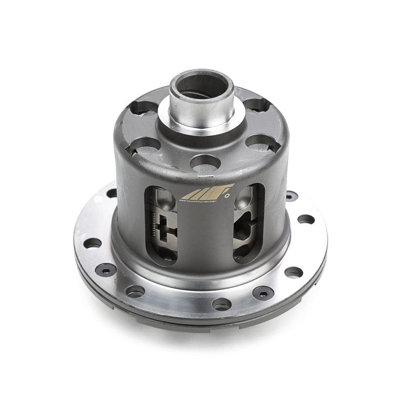

El de Kaaz (DBH2010) es de discos:
http://www.kaazusa.c...hondaacura.html
8601_KAAZ_DBH2010_FS02-01@2x144684464456
MODEL     ENGINE         GRADE    YEAR     M/T     POSITION     NORMAL     L.S.D. TYPE     PLATES     PLATE SIZE    1.5WAY CAM     REMARKS
S2000
AP1     F20C VTEC           99.07~     MT     REAR     Torque Sensing     BASIC         12     M         DBH2010
AP2     F22C VTEC           2003~     MT     REAR     Torque Sensing     BASIC         12     M         DBH2010
Más info:
https://tomson.com.p...00-AP1-AP2.html
Producer:    Kaaz
Differential type:    Plate type 1.5 way
Ramp angle:    45/20 (1.5 way)
Preload:    6.5-7.0 kgm
Plates:    12
http://realstreetper...2C-DBH2010.html
KAAZ produces two configuration types commonly classified as 1.5 way or a 2 way. This designation reflects the design of the cam groove which enables the LSD to function differently under acceleration/deceleration loads. The 2 way is constructed in a way to have positive lock motion in both acceleration and deceleration mode, the 1.5 way functions similar to a 2 way under acceleration however provides less lock-up when decelerating. The 1.5 way may provide more forgiving balance depending on vehicle setup and driver skill when braking is compared to a 2 way setup. For Front Wheel Drive vehicles the 1.5 way is also very effective providing extra stability during braking.
Typically the 1.5 way differential is suitable for all types of motorsports driving. With optimized performance during acceleration it carries a lighter lockup on deceleration which is best suited for traditional road racers. Despite the fact that 1.5 way units have slighter lock up on deceleration, many users may still use this cam type for aggressive motorsports such like drifting or low gear auto crossing & gymkhana.
Kaaz Limited Slip Differential (LSD) is the choice differential for drifting, road racing, autocross/gymkhana, drag racing, spirited driving, and any other forms of motorsport. Kaaz LSDs react fast without fail to provide much needed traction to the wheels when cornering and accelerating. Kaaz Differentials are designed w/ the largest and most number of friction plates to increase drivetrain response and reliability under harsh driving conditions.
La virgen! :P
Qué de juguetes! :meparto:
